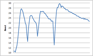

Data from the quarter mile run that blew it...
I don't see any obvious problems, but even small counts of knock can be dangerous when the tune is this aggressive.

your quite lean at that knock... not overly so, but you dont give yourself much leeway if your WB is wrong...
hopefully you get back on the road asap
