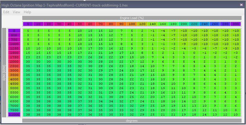

Old Jun 18, 2009 | 07:15 PM
bsmart82's Avatar
Joined: Nov 2008
Posts: 82
From: Bryan, TX
New logs.

Old Jun 18, 2009 | 09:58 PM
R/TErnie's Avatar
iTrader: (32)
Posts: 5,380
From: WAR EAGLE!
try that again. Blue is advance. Red is retard. 1=1 deg 2=2 degrees
Get a handle on your lower RPM AFR's you're running at 10.6:1 in some areas. Lean those out. You may find that you'll need to retard timing as these AFR's get in check. It'll show in the logs. LMK
Old Jun 19, 2009 | 05:10 PM
bsmart82's Avatar
Joined: Nov 2008
Posts: 82
From: Bryan, TX
I was able to make two 3rd gear pulls on the new timing map. I also tweaked the fuel map and it is closer to where it needs to be. I ran my og tune through Jack of Trades dyno sim vs. the new timing map and picked up a few HP up top. It seems I have lost some HP/TQ up untill 5.7k and I can feel it. I'm sure this is from the lower timing down low, so should I add more timing there since it's not knocking?
Attached Thumbnails Opinions on tune...-newtimingmap-medium-.jpg   Opinions on tune...-dynosim-medium-.jpg
