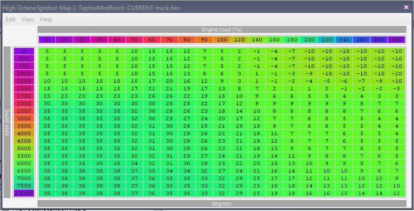

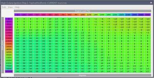

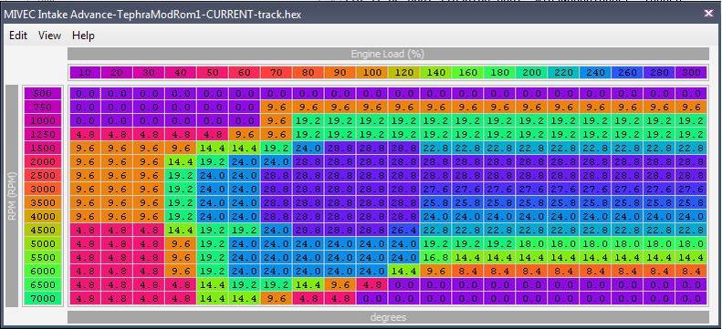

Maps
Attached Thumbnails Opinions on tune...-fuelmap.jpg   Opinions on tune...-mivecmap.jpg   Opinions on tune...-timingmap.jpg

fuel still looks a bit rich in some areas - whats ur AFR on the WB?
MIVEC map is the JDM RS map right? - should be good (never tried it)
timing looks high lol - what fuel is this?
what boost and load at peak and redline?
any knock?

Fuel is 93, boost is at 23 tapering to around 17-18, and no knock. Load usually spikes to 260-270, and then goes 240 and tapers off to 210 up top. That is a slightly moddified JDM RS mivec map. AFR is consistent at about 11.2-3 leaning out a little to 11.5-6 up top. I also have lean spool disabled. I hosted the logs above if you missed them, If you can't dl them I can post screen shots.

i am suprised you dont see knock those timing values are high. plugs?
