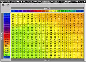

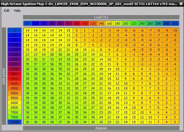

I do feel that the car slows down if i use nlts. But i have no knock at all if i shift with nlts off.
this is my ignition map, i would appreciate if you could show me my mistakes, or give an example of correctly smoothed timing.

Old Jun 15, 2009 | 04:26 PM
rolly1818's Avatar
Registered User
Joined: Nov 2007
Posts: 1,507
From: Trinidad
it not so much ur smoothing.
at high load (160 - 210) and high rpm ( 6000-7500) ur timing is too high so when ur car clips these cells under shifting or NLTS knock will occur (the reason you dont get it on normal shifting is u dont shift fast enough).

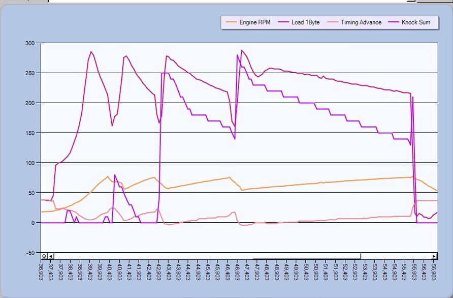

Post the log too.
But just lower the timing in that area, the map will not be smooth, but really when was the last time you hit those load cells?

Originally Posted by Biggy VIII
ok I will log me shifts and post them here in a couple of days.
Here it is...
