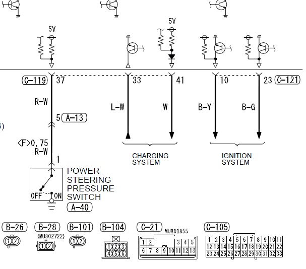

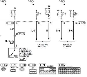

03whitegsr. check out pins 33 and 41. The ecu does infact reduce alternator excitation during high load. The Vbatt will drop at wot, but not to 12.6v. The lead acid battery being on a trickle charge the entire time your driving will not drop to 12.6v instantly. If you stayed at WOT for a long long time, you would see the voltage lower. I dont know if the ecu completely kills the excitation, but i know it reduces it. If the battery dropped that much from electrical demand, that would be crazy crazy. The engine does not need electrical power like huge subwoofers. Injectors and ign coils dont use that much power.

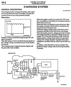

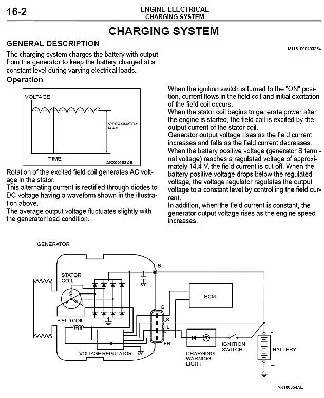

This too. Ecu is directly connected to field coil.
Sorry man, I completely disagree with you on this. Yes, the ECU controls the field, but no it does not shut it off under load. You shut off the field current to the alternator, the voltage will IMMEDIATELY drop to 12.6 VDC or lower, regardless of the electrical load.
