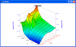

Please have a look what you should see in ECUFlash with the XML.

Download tuner pro.
Download nynet's .xdf and the binary of the same name, not tried ones that end in anything other than M, but M works.
Open tuner pro, open the xdf and then open the ROM and look at the tables.
