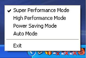

yeah it is related to CPU processor timing. do you have a screenshot of where you changed this setting? what was the other thread post?
Old Jul 27, 2009 | 11:22 AM
acamus's Avatar
Joined: Mar 2008
Posts: 730
From: Lattitude 48.38°, Longitude 17.58°, Altitude 146m = Slovakia, for common dude
I believe he is referring to my post
Attached Thumbnails evoscan No response from ecu(ecuflash work)-super-hybrid-engine.jpg

yeah it appears to be a bug in the kernel CPU drivers, perhaps Intel?, make sure you get an updated drivers from your manufacture. Reflashing also works in EvoScan fine, because relfashing doesn't require any timed commands, but the datalogging does.
