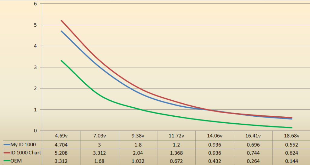

Bumping this thread as I just installed the ID 1000's. Attached is a graph I made to determine my latency settings. I first plotted out the listed latency values sent with the injectors, then I added the Ecuflash voltages and plotted each one from there... I noticed with rawkus's latencies plugged in, the overlap was at 11.72 volts, where mine is at 14v where we spend most of the time... I tried to keep all the latency values set to what we can select in Ecuflash, but I don't have my laptop in front of me so some aren't accurate...
Plotted with ID's voltages & Ecuflash's voltages
With just Ecuflashes voltages and smooting applied
scaled to 835
LTFT Low= -0.8%
LTFT Mid= -1.75%
Attached Thumbnails Question about Bosch 1000cc Injectors-id1000_plotted.jpg   Question about Bosch 1000cc Injectors-id1000_final.png

Fast Fred,
43.5psi fuel pressure?

Have you guys done anything with the base latency values?
If it is the same scaling as the normal injector latency, then the ECU has an offset of 0.576 ms added to it. When you add that latency into the setup, it changes the higher voltage dead times by a large amount.
These values are based on my IDC dead times.
Code:
			IDC1000					Stock
Voltage		Latency Table 	 Total Latency	 	Latency Table 	Total Latency
4.69		5.544		6.120			3.312		3.888
7.03		2.544		3.120			1.68		2.256
9.38		1.344		1.920			1.032		1.608
11.72		0.744		1.320			0.672		1.248
14.06		0.408		0.984			0.432		1.008
16.41		0.168		0.744			0.264		0.840
18.68		0.024		0.600			0.144		0.720
