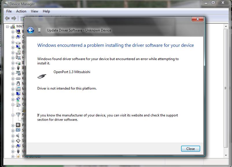

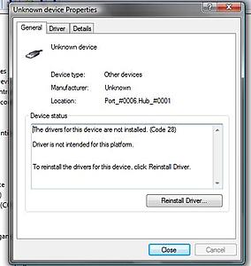

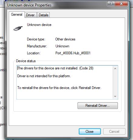

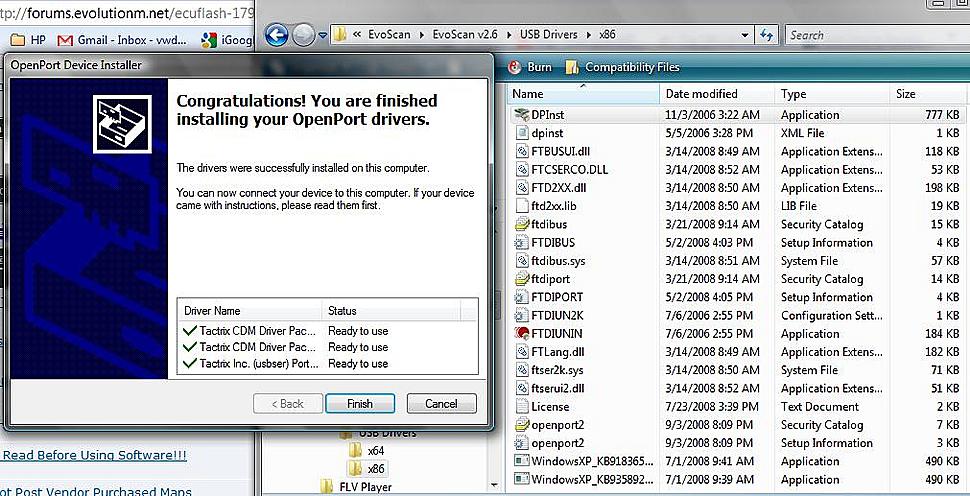

To make a long story short I had to uninstall a BUNCH of programs, drivers, etc. I have successfully reinstalled ecuflash and evoscan. My problem is when I hook up the openport/tactrix 1.3 cable to the laptop. It comes up with error messages and some other gibberish.
When I installed ecuflash, the cable drivers all installed properly (3 total). Here are some screen shots of what I've been running into.
I have tried <browsing/ecuflash/drivers/64x. No luck.

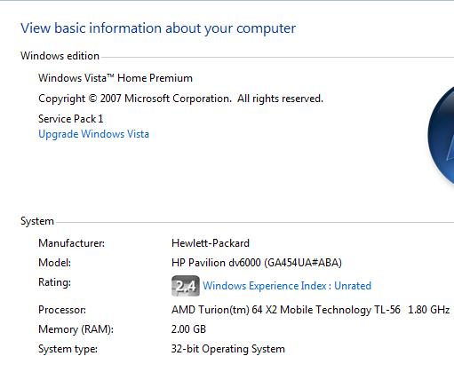

I am running Vista64, I think, or is it 32? I'm not savvy with computers at all.
Any help with this would be very appreciated.
I did notice that I used to have a "program" called FTDI. It isn't there anymore and I'm not sure if that's the problem.
Attached Thumbnails !Help with Openport 1.3!-stupid-openport.jpg   !Help with Openport 1.3!-stupid-openport2.jpg   !Help with Openport 1.3!-stupid-openport3.jpg   !Help with Openport 1.3!-stupid-openport4.jpg

FTDI is the chipset used inside usb<-->serial converters. Used to connect e.g. Zeitronix AFR with serial output to a newer notebook without a legacy serial port. However, the FTDI driver is also required by EvoScan/EcuFlash/OpenPort 1.3U (I'm guessing the OBDII port behaves like a serial port and there is a FTDI chip inside the Tactrix cable too?).
It looks like you have the wrong version of the driver installed for the version of Vista you have.
How to determine whether a computer is running a 32-bit version or 64-bit version of Vista:
http://support.microsoft.com/kb/827218
From http://www.limitless.co.nz/evoscan/
- For USB cable drivers either download and install ecuflash or run DPInst.exe from
32-bit: C:\Program Files\EvoScan\EvoScan v2.6\USB Drivers\x86\
64-bit: C:\Program Files\EvoScan\EvoScan v2.6\USB Drivers\x64\
Notice the different ending.
If that doesn't work, I'd try uninstalling & reinstalling EcuFlash first, check that works e.g. by reading your ROM, and then install EvoScan again afterwards. 64-bit Vista support was only added to EvoScan recently, so I would just try and get v2.7 Beta2 running, and not try the older versions.

Well, I'm definitely running 32 bit vista, I uninstalled ecuflash and the tactrix driver. Rebooted. Installed ecuflash and all 3 parts of tactrix driver successfully. Downloaded ELM. Hooked up openport cable to laptop- same ****. This is so annoying. Anymore ideas on what could be going on here?
Please help.
Edit: When hooking up the cable to the laptop, it recognizes it as the openport 1.3, searches preconfigured drive folders for a second, goes right to searching windows online update, then to installing software, then failing. Maybe that will help somebody help me a little bit.

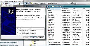

How come I can install the drivers properly using the driver folders from either evoscan or openecu, but when hooking up the cable and I "browse folders" and select the shown folder, it won't work. Getting pissed off here. This makes no sense to me.

By searching in the folders your computer is informing you that your driver is not installed yet.
This is the important stuff from Hamish
Laptop Requirements:
EvoScan/EcuFlash/OpenPort 1.3U Requires installation of USB FTDI drivers (installed with ecuflash, or EvoScan will auto install them if no drivers found on logging)
Otherwise you'll get this message: FTD2XX.DLL missing
you can manually install the Evoscan USB drivers: from C:\program files\evoscan\EvoScan v2.5\USB Drivers\x86\DPinst.exe /i
ELM327 USB Cable Drivers and Software: Download Here
Requires installation of Microsoft .NET Framework v2.0 (its not installed by default on WindowsXP, but it is installed by default in Windows Vista)
Otherwise you'll get this message: "The application failed to initialize properly (0xc0000135)." - to fix install MS .NET Framework v2.0
Basically if the laptop can run Windows fine, then the EvoScan software will also run.
So double check that you have .net framework 2.0 (it should be under vista) then run Evoscan to see if the drivers will install automatically. If not then you need to follow his procedure to manually install the drivers. I am surprised that they aren't already installed properly with the ecuflash install. Maybe before trying to install more drivers you should go to device manager and check what the cable's status is. Go to Start > Control Panel > Device Manager and the cable should probably be under the Ports section. Right click on the heading for the cable and select properties. You should be able to see what Windows thinks about what is going on with this device on the opening tab but go to the driver tab and select uninstall. After that try uninstalling Ecuflash then installing it again.

Figured it out- the new version of ecuflash wouldn't work with my laptop- didn't install drivers correctly. Installed 1.39 and everything is good. Now I just need to get a copy of my base file from the newest version and paste it to this version.
