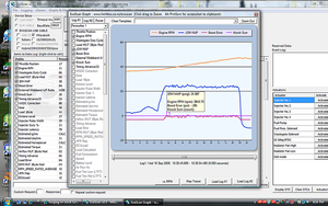

Originally Posted by mrfred
After switching to an exposed element filter a few days ago, I can hear the turbo much better, and when the motor is spooling starting from 2200 rpm for a 3rd gear log, I can hear the turbo stuttering a bit. Its not enough to show up in the logs, but I can feel it. I figure its either surging, or itsthe 20 Hz duty cycle of the BCS causing the WG to oscillate.
I get this stuttering as well.
I just noticed Im surging a bit in 5th...

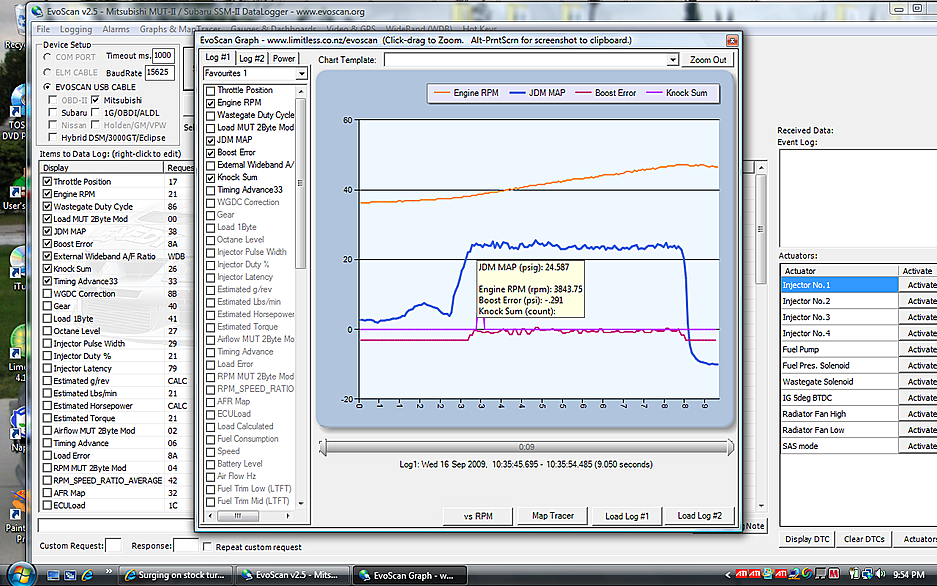

Old Sep 17, 2009 | 07:12 AM
FlintownKilla's Avatar
Joined: Sep 2007
Posts: 70
From: North Ogden
I have also experienced what I would asume is some kind of break-up/surge with my car on e85, tt happened as the turbo was spooling up to peak boost ~3500-4000, under high load and typically happened more often in 4th gear and higher. However, when I turned my boost up past 28psi it went away, dont know why. Maybe if you turn up the boost and it goes away, you can figure out more about what is going on.
