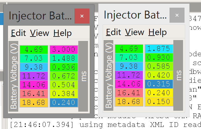

For 9653 and ID2000s, please correct me if this seems wrong.
Can someone advise from here? Continue using old values or use new scaling to match ID's specs?
Code:
8 Volts	10 Volts   12 Volts   14 Volts  16 Volts
1455	950	680	495	375
On left is old values taken from John Bradley's post here, https://www.evolutionm.net/forums/ec...ml#post7508281
New values on right.
Code:
<scaling name="InjectorLatency_NEW" units="ms" toexpr="x*0.015" frexpr="x/0.015" format="%.3f" min="0" max="4" inc="0.015" storagetype="uint8" endian="big"/>
 	<table name="Injector Battery Voltage Latency Compensation NEW" category="Global Fuel Settings" type="2D" scaling="InjectorLatency_NEW" address="37c0">
		<table name="Battery Voltage" type="Y Axis" elements="7" scaling="BatteryVoltage" address="67f0"/>
	</table>
