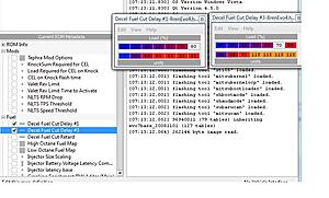

What about these for 9694001? Do they look right?

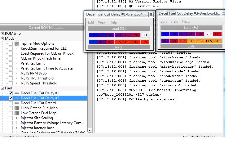

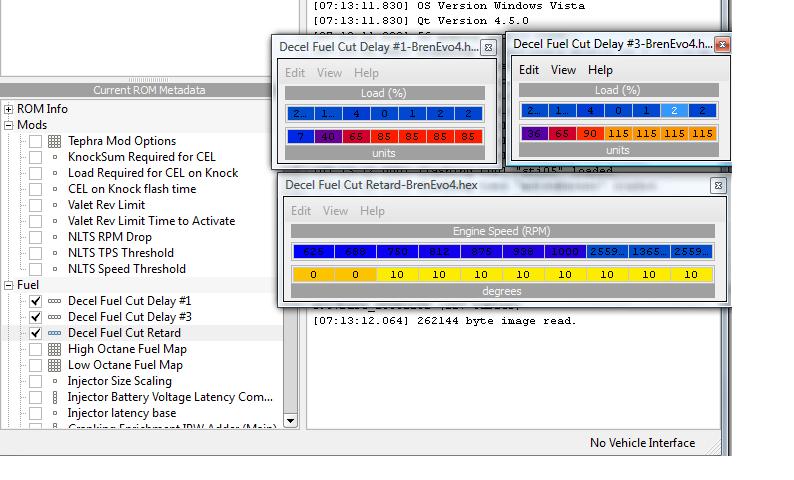

What about now? Do they look correct now?

Ah, yes, sorry about that; I didn't look up the load axis on those 2D tables; that's what I get for cutting and pasting. Looks like your pick is off by one; try the address "5d52" for the load axes, and "594e" for the Engine Speed axis on the Decel Fuel Cut Retard table. (I updated the original post.)

No, I mean #2 and #4 appear to reference the exact same tables as #1 and #3 (ie. same ROM addresses). It's kind of a messed up situation, and will probably force me to actually read the code for sub_CC6 and sub_C28 and figure out how the heck that table gets parsed.
I could be misreading this, though, which is why I'd love someone else to take a quick peek. l2r99gst, if you're reading this, are you still even remotely interested in 96940011?
Also, it looks like I might have been wrong about the Engine Speed axis for Decel Fuel Cut Retard; the address is actually 5a22, not 594e. (Not that it matters, unless you're planning on rescaling it, since the values are the same, but better to be accurate.) Again, I've re-edited my post to reflect the correct value.
