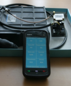

BlueMUT - logging via cellular
Minimal requirements for cellular are CLDC1.1, MIDP 2.0, JSR82 and JSR 75.
Yes its J2ME, which makes it portable to any PDA/cellular, it uses bluetooth connection.
The BlueMUT is configurable by EvoScan Data.xml, but I may convert it to mitsuloger requestID.xml if Hamish will have objections.
The logging speed is around 12 (min 10- max 14) requests per second which is not bad if you take processor power of cellular into account.
In near future I shall code storing of logged data to csv at memorycard present in almost all cellulars today. Next step will be adding DTC support.
I have started this project already in January, finally I can share some pictures with all of you.
Attached Thumbnails BlueMUT - logging via cellular-bluemut-ecu.jpg   BlueMUT - logging via cellular-bluemut-n5800.jpg

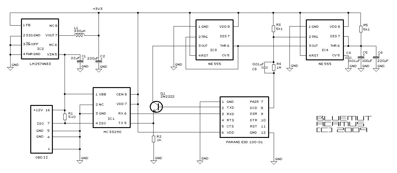

I have drawn a schematics for hobbyists.
I may even arrange some production if enough interest is shown.
You can download application from this post.
Application is still in development stages, but one can already log.
My main interest was to have a knock gauge.
If I will come to the stage that source code is presentable, I will post it.
I know I will never get enough money to buy me an EVO, but if you feel like it is valuable for you, you may send some donation
If you want to go commercial with it please ask for permission.
