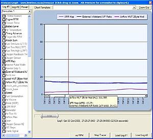

I'm running an Evo 8 Ecu on my 97 Eagle Talon. I recently got around to properly scaling the MAF (2g DSM) but I'm having 1 problem; I need a 350Hz row. The AFR are fine at 302 and 403 hz, but it goes lean (some times as much as 1.2 AFR) in between. This also happens to be the same hz area I'm in when I go from crusising into boost. I think this may be the reason I'm knocking.
I need to know what other tables may be messed up if I removed my 25Hz row and added a 350Hz.
