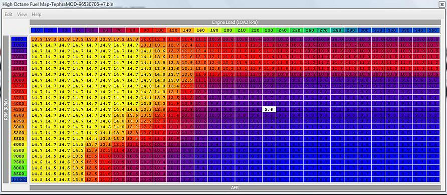

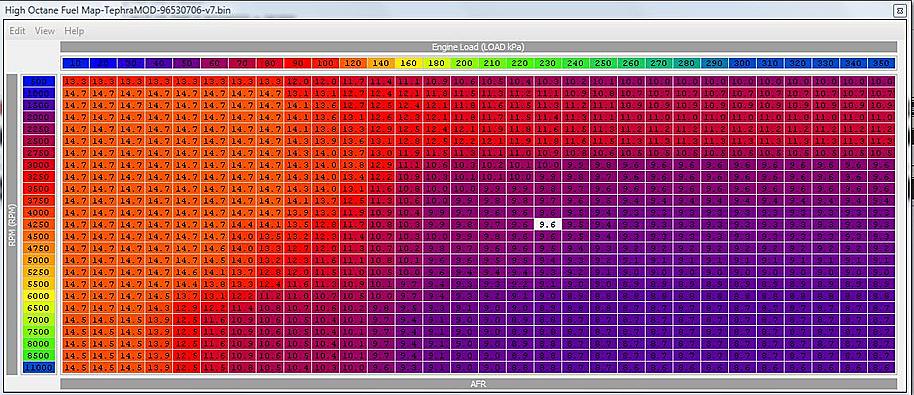

JoT, love your .xml. So clean, so organized. Just have one lil suggestion...
IMO, the scaling for AFR need to have its "display min" and "display max" at 8 and 20, instead on 5 and 30.
This makes it so this
Turns into this
Attached Thumbnails TephraMod V7-wrong-colors.jpg   TephraMod V7-right-colors.jpg
