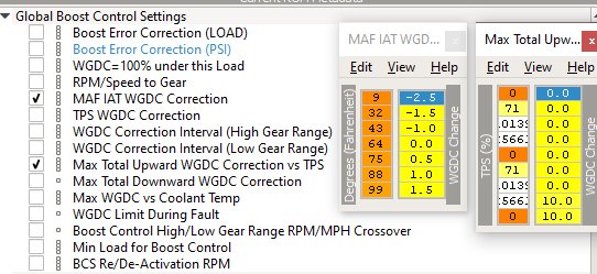

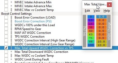

Need XML for V7+Mods 88590715
Does anyone have a copy of the lupdated XML.
Originally Posted by phenem
I just updated the second post with the correct XML and correct ROM with the appropriate mods and speed density patches. Please delete and re-download and replace what you have (at least the XML so we are all running the same)
TephraMod V7 USDM Evo IXOption 1 88590715 (v7) - Download Option 2 - Thanks to recompile 88590715 (v7 + Mods) - Download | MirrorSetup for JDM MAP and PSI based boost control (mrfred)WGDC Correction Interval set to 1 (Stock = 10)Max Total Upward WGDC Correction @ 100% TPS set to 0 (Stock = 10)EGR System Disabled (mrfred)Max Timing Retard set to -20 degrees (tephra)FAA bit.10 disabled ("weird unknown" timing pull at cruise)FAA bit.09 disabled (cat-warmup ignition retard)FBA bit.00 disabled (lean spool)FCA bit.09 disabled (EGR Test)OBD Inspection set to Pass all tests (acamus)Rear O2 Heater patch applied (mrfred)Fuel Cut Load Limit x2 and set to 300 (mrfred)
