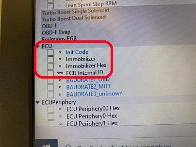

I drive the EDM EVO 8
With Tephra i have to change the Immobilizer HEX to 004D. BUT whats with the Init Code and the Immobilizer. Do i have to copie this from my base File or i don't touch this?
Old Apr 16, 2021 | 12:22 AM
  #3621
EMR88's Avatar
Joined: Dec 2020
Posts: 17
From: Nic
Don't see any reason to change that. If different, set it to you previous/last working ROM.
