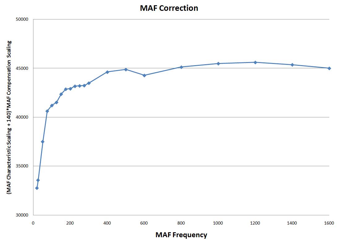

Originally Posted by Slo_crx1
Thank you! I'm going to leave the map VE where it sits since it seems to work rather well how it's scaled, I just want to adjust rpm VE accordingly since the way it looks right now is pretty much a mirror image of my MAF scaling table and at times it's been troublesome for me to get the correct VE for a certain range (even harder now that my laptop erased all my previous maf logs ).
This probably won't work exactly as you are hoping. There will be more involved, but I think in the end, it produces a more realistic way to manage the engine. Instead of putting in values that just make the car run, you end up with values that actually seem to reflect what I would expect from a real engine.
I have done exactly what you are after. The first thing I did was to look at the total effect of the MAF tables. Think of the tables as a scalar in the end.
Scalar = (MAF Characteristic Scaling+MAF Offset)*MAF Compensation Scaling
The chart below shows the factory MAF curve.
I wanted two things to happen. I wanted my WOT stuff to change very little and I wanted my MAF Compensation table to be 128 across the board. Doing the later allows me to use that table to trim up any airflow related problems I may encounter (which I have).
The peak value of the stock table is 45617. To get there, you can use 216 in the MAF Scaling and then 128 in the compensation scaling. This produces a value of 45568 which is a 0.1% error.
I think you’ll find that you can get the MAP and RPM tables very well tuned in, but then your idle will be very rich. This is where the MAF Comp below 75 Hz comes into play…
