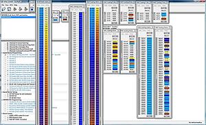

I'd be happy to help setup a newb do-it-yourself post as that's what I am and I seem to be hitting every road block out there.
One more issue that may have been covered already in the 1000 posts in the Tephra V7 thread...searching turned up some related posts but nothing that seemed to match the problem exactly. That thread is so large that finding anything specific to the SD patch is about impossible now.
The MAT tables seem to be wrong in the ROM phenem posted. I was under the assumption that the ROM was pretty much plug and play. You hook the GM IAT into the fuel temp input in the ECU and use a MAP sensor in place of the MDP sensor, you load the rom and you start playing. Logging MUT 9 shows completely bogus results in Phenem's ROM.
Looking at the tables for the SD patch though, the SD IAT ADC values do not match the values from mrfred's MAT patch. Also, if you load up the tables from mrfreds patch, none of them show up correctly in Phenem's ROM.
The first two tables on the right show the SD patch tables to use the Fuel Temp input and then the scaling for the IAT.
The tables to the right are the MRFRED patch tables, with the values from his pre-patched ROM on the right and the Phenem SD patch rom on the left.
Should I patch MrFred's tables into this ROM?

Yes

For the 96530006, my recollection is that my MAT patch is not required. The reason is that there is no fuel temperature measurement in the 96530006. So its good-to-go that way. However, I've made some updates to the 96531706 xml that may help with tuning SD. The most substantial update to the xml is the addition of all the correct or better defined accel related tables. I can post it up tonight sometime if you want.
