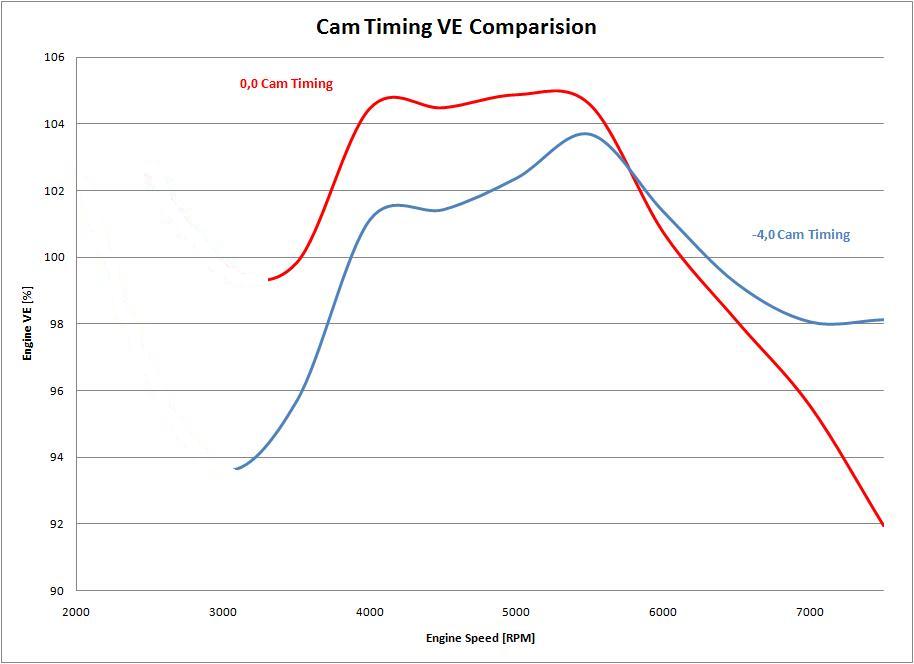

One thing I have been playing with however has been cam timing adjustments as I wanted to get an idea of how much cam timing will affect the RPM VE table. It's fairly substiaintail. Below is a graph showing the approximate VE values I have to use on my car to match the AFR table to actual AFRs.
FP 280+ cams
Ported IX turbo/manifold
Ported head, stock valves
Home brew intake manifold porting (similar but inferior to Wilson V2.3)
The 0,0 and -4,0 values are the results from testing a ton of different settings and the 0,0 represented the best power under the curve where -4,0 made the best peak power. This data was collected using 4 pulls on each cam setting, same stretch of road, 30 minutes of total time for all 8 runs, 2 runs each direction to average out road conditions. This is the AVERAGE of all 4 runs for each setting.
