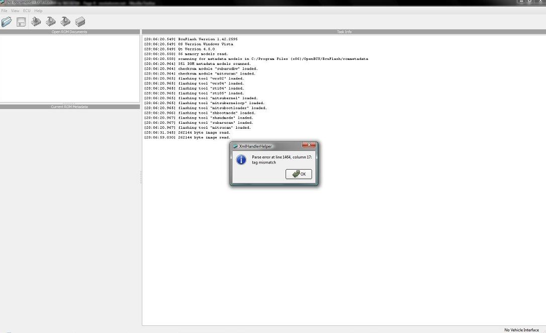

hehe, i added the new table in ecuflash and changed input the new amounts, saved/closed is. i just went to open the rom so i can flash it to test and got this error...
is it something that i missed of something to do with Vista 64?

^^^ thats coz you need v7 this is a thread to convert from 96260009 to 96530706. download you version of v7 from here:
--> https://www.evolutionm.net/forums/ec...hramod-v7.html
