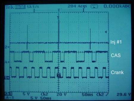

Just from what I have gathered, the ECU uses interruptes to actually fire the plugs.
The crank signal has a falling edge at 5* BTDC that it uses to sync the interrupt. This is of interest because if the timing advance desired is higher then 5 degrees, the ECU has to estimate when to fire the plug without an actual interrupt. I would imagine it keeps the falling edge constantly monitored to verify it falls when it expects it to. Part of this likely has to do with the P0300 test even.
The leading edge of the signal happens at like 75* BTDC, based on measuring the crank trigger plate.
The alignment of the cam and crank signals is unique. I beleive at any point, it can tell which set of plugs to fire and within like 70 degrees or so, the ECU can determine exactly which cylinder is approaching TDC.

Originally Posted by 03whitegsr
The alignment of the cam and crank signals is unique. I beleive at any point, it can tell which set of plugs to fire and within like 70 degrees or so, the ECU can determine exactly which PAIR of cylinders is approaching TDC.
wasted spark eh?
