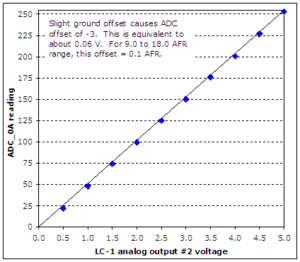

I've been doing this since last fall on my DSM. The only difference is that I modified the code so that I spit the 0-5v signal straight to the front O2 sensor (the only sensor on a 1g DSM) and modified the code so that the high/low switching points for stoich are 2.5 volts instead of .5 volts.
Anyways one important thing that I learned is that you will no doubt have a grounding loop issue. Maybe it was mentioned, but I did not see it. Anyways calibrate the LC1 to spit out 0 volts at all times and then fire up evoscan. Does evoscan report 0 volts? Ok now make the LC1 spit out 5 volts at all times, does evoscan spit out 5 volts? Do the same for 2.5 volts.
For me a few hundredths of a volt is quite a huge AFR discrepancy. I just thought I'd point it out. Thanks for the work mrfred.
I was kinda curious about this too, so I checked it out across the entire voltage range. There is a consistent offset between the predicted ADC value and the actual ADC value of about 3. Its roughly equivalent to 0.05 V. For an AFR range of 9:1 to 18:1, this is equivalent to about consistent 0.1 AFR which is very reasonable. Since it is consistent, it can even be eliminated by adjusting the formula in EvoScan.

did you look at my post above?
it seemed that the error was greater the closer to 0v the ADC got.

Yes the error typically is not linear with respect to voltage output. Welcome to the world of analog ground loops. This is why I prefer the digital input from the devices as my *accurate* way of logging when fine tuning it. I will then use the analog input from the LC1 for "quick and dirty" logging. IE: when your at the track and just need to fire up the logger and measure a few things just to make sure you are in the ballpark or to spot big issues.
I'm seeing about a quarter AFR point when logging my DSM and I have the LC1 grounded directly to the metal case of my ECU!!!!

Here is what I'm seeing. Its just a systematic offset.
