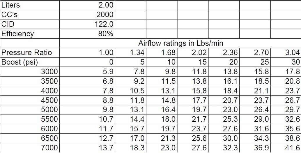

how much airflow an engine consumes at a certain pressure ratio....
