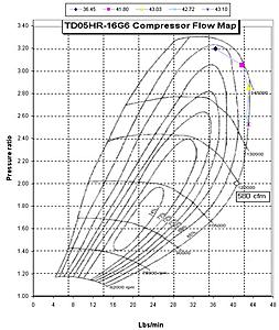

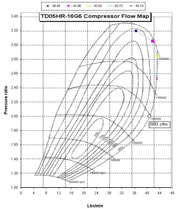

Awesome info, thanks!! Has anyone created a spreadsheet that estimates transition through the map?
I had started something a while back but gave up. I was trying to do something similar to you Applaudd, to see at what point it was not worth pushing the stock turbo.

I was thinking about this for sometime also, and it seems 550 CFM is a reasonable limit for 16G6 EVO 8 turbo. (at 70% efficiency) If we do not mind rotating turbo upto 145000rpm which is the maximum shown at the map, then 615 CFM or so might be the limit, but I guess that is not what we should aim for. 550 CFM is about 303 g/s, and it may depend on the mods and other environmental variables, but 230 load @ 7000 rpm is about 282 g/s. So I guess there is about 8% more room. But unless I can efficiently cool the charge temp down, more air flow does not always mean more power. That is probably why many gurus here are saying that 19~20 psi @ redline is reasonable limit with stock turbo.

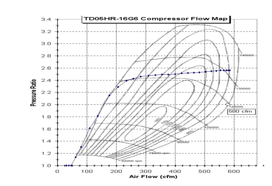

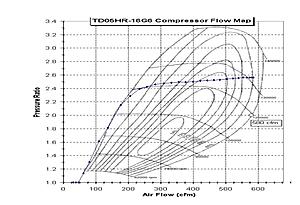

Here's a rough trace from one of my last logs, maxing out the stock turbo on E85. This was a 32psi spike to 22psi at redline. I only plotted the points from 4000 to 7000RPM:
As mentioned before, I'm maxing it out. I'm trying to run as much boost as possible. It's just limited by the compressor wheel now.
Eric

Ahh I see now, so they are one and the same. I just saw the first tab with all the inputs. I was trying to do the same thing, but this has already been done thanks!!
I'd say you have just about maxed that turbo out lol

I was using rough numbers that I got from my SD tuning. About 100% midrange, falling to 85ish at 7k. VE numbers will differ from car to car though, as selection of parts hugely alters VE (cams, exhaust, IM, IC, etc, etc).
Higher VE cars at the top end won't be able to hold as much boost as a lower VE car (on a maxed out turbo). For example, with my cutout open I was able to hold about 22 psi, with it closed I was able to hold 23 psi, because my VE was lower with the cutout closed.
If you are maxing out the turbo though you can sort of see what your VE is as it will follow the line down the map.
