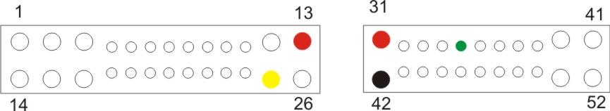

ACD without AYC pinout
This is the pinout of the ECU that i posted earlier.
S.

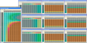

Break-thru: Reading ACD ECU with EcuFlash-acd_maps.png
Some of the maps.
Really need a ACD log to go any further.
