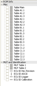

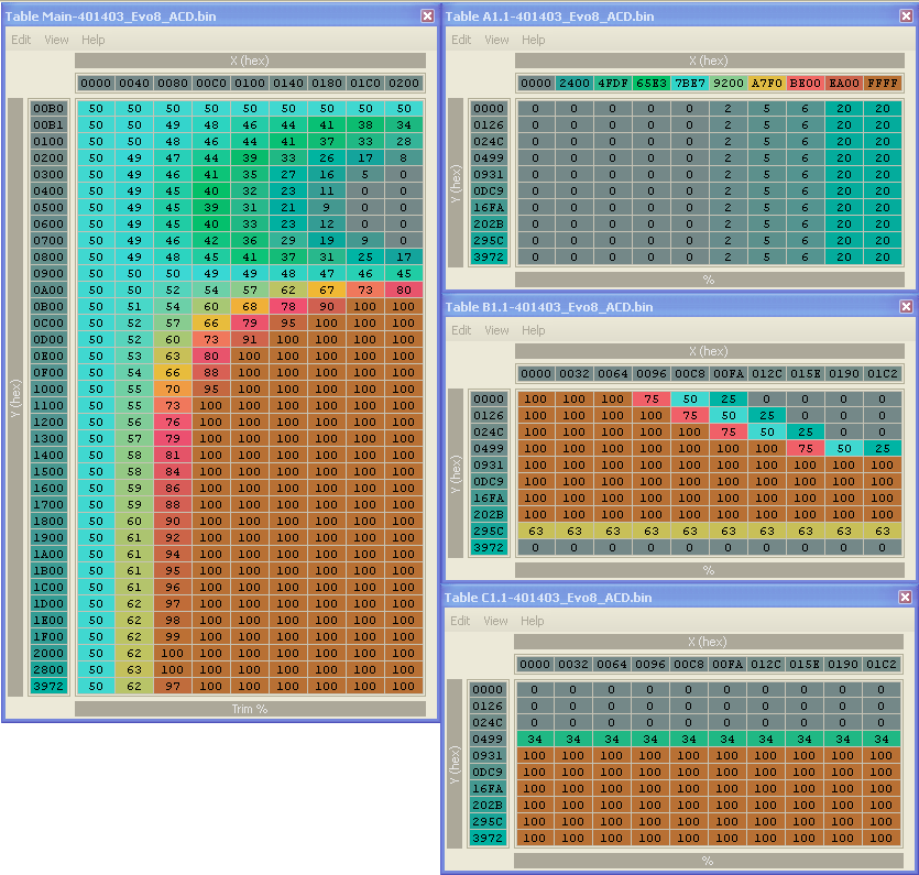

Evo8 ACD definition so far.
Download -> 401403_2-11-10.zip
All 3D tables defined. Correct axis are attached to tables, but scalings not found yet.
Added Hex ROM Id, to EcuFlash header, for differentiation between minor versions. 4014 is rom name, 03 is minor revision.
Tables are named like A1.1, A1.2, A1.3, A2.1, A2.2, A2.3.
A1.1 A is the table group.
A1.1 1 is switched in the ecu by something I have not found yet.
A1.1 .1 is switched by Tarmac, Gravel, Snow. Not sure of order yet.
So there are six tables in group A, but only one will be used.
Break-thru: Reading ACD ECU with EcuFlash-acdtables.png
Break-thru: Reading ACD ECU with EcuFlash-acdmaps.png
If someone can please log the ACD with EvoScan. Then I can find the scalings for the axis, and what the tables do.
There are also 30-40 2D tables, but without knowing what they do its pointless to add them.

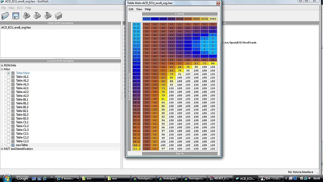

dont know if this will be correct but i had a little play with the table addresses and scalings and came up with this for the main table.im still new to dissassembly
Attached Thumbnails Break-thru: Reading ACD ECU with EcuFlash-ecuflash-screenshot.jpg

Evonut, not entirely sure that the Y axis would be 122.5% TPS angle. The hex value 3972 is referenced in almost all the other tables it seems though.
Yeah I was kind of assuming that
