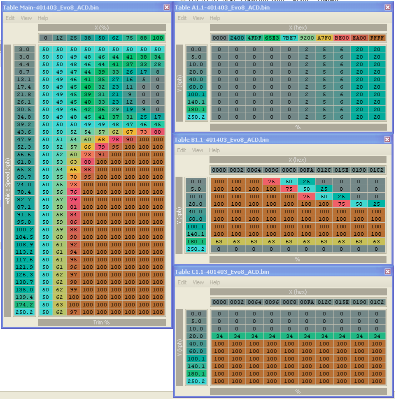

Edit x2:
0x19 Spd_Com2 is directly tied to all the 3-D tables Y axis.
So looks like all the Y axis are Vehicle Speed.
Code:
mov:g.w @F208_BigY_Axis:16, r0
cmp:i.w #0xB0:16, r0
bhi     loc_1AAD2:8
clr.w   r0
loc_1AAD2:
mulxu.w #0x45B:16, r0
mov:g.b r0, @F4FC_WSpd_Comn_2:16
If Y_Axis less then 0xB0, then Spd_Com2 = 0
Else Y_Axis * 0x45B / 0x10000 = Spd_Com2 [Keeping low byte only]
NM Figured out. They are keeping most significant byte, dropping lower 2 bytes(r1).
Y Axis units = Spd_Com_2 units * 58.78
So if EvoScan conversions are correct, axis looks like this in kph. (Looks correct)

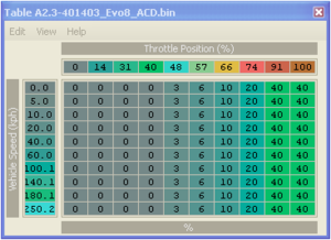

I think this should work with all 8 & 9s, except the S-AYC maybe.
A Tables are Throttle Position x Vehicle Speed
Break-thru: Reading ACD ECU with EcuFlash-acd_a_table.png
(Could possibly be TPS Delta)
