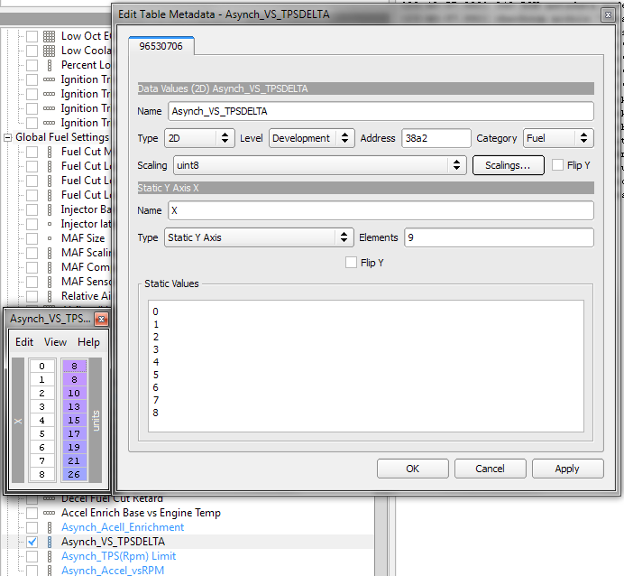

I'm running the 95630706 v7 rom on my 2g DSM.
I keep going lean on throttle tip in and it's causing knock. Is this the right map to be changing?
Just making sure before I change anything. Jumping to 15:1 AFR or leaner during spool up (lean spool is disabled) isn't the greatest.

Yes, the Async Accel Enrichment is the table to adjust.
