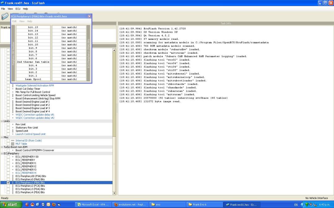

found the xml, i have added it to my evo7base, evo9 base, evo5 base,
i can change the figures in all my evo 7 onward roms
But the 6 rom says "no match" where as the evo 7 up lets you put a 1 or 0

Looks like the addresses are different.
One of the Gurus can get the address for you if you send them your rom.

change lean spool start and stop time to same 2500 or change ecu periphery1 (fba) bit0 set to 0
