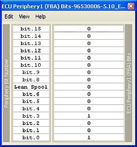

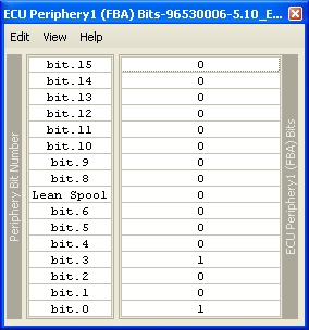

For the 96530006 ROM I see the Lean Spool bit labelled as Bit 7 in FBA.

From: Melbourne, Australia
Yeah I queried that in the thread about bit's.
I think its wrong.
