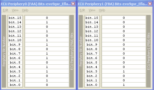

This is odd b/c i'm looking at my rom, stock rom, and tephra pre-patched rom and the all have "0" for bit 7 (FBA) ... does that mean by default it is disabled?

I think Bit 7 is the incorrect bit. Tephra mentions it is Bit 0 and seems to work.

I'm using 90550001 rom, and fba was set to 0009 (bit0 and bit3 active, lean sppöl enabled) switching to 0008 (bit3 active, leanspool disabled) won't disable leanspool. AFR stays the same.
Setting start leanspool and stop leanspool to 2500 made slightly lower AFRs.
