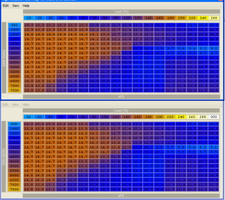

We aren't talking about a decay table. We both switched over to the tephra mod roms and just copy and pasted. Not paying attention to the load % at the top of the table.

Lets see fuel and ignition were my main ones. Here a picture is worth a thousand words. To an untrained person, like myself, these maps looked the same and I couldnt understand why the car would go so rich at very low load. Went back through and actually paid attention and found my problem. Make any sense now?

oh right. so you didn't rescale the load axis??

Yep being a newb sucks. I followed the writeup on how to do everything, either I missed that part or it wasnt there.
