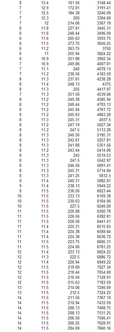

Here is how I tuned my a/f ratio. Log is timing, afr, load, rpm. I don't log boost, but it is set to 24psi tapering to 19-20.
