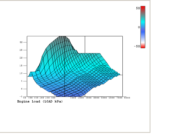

Currently the ignition timing in v7 is only adjustable in whole degrees of timing advance. With the addition of v7 and the increased breakpoints (resolution) the interpolation only happens within a small change in load/rpm. This results in a "rocky" looking timing map and not a smooth one that would've been experienced/generated from a v5 timing map.
I give you Fast_Freddies v7 timing map on pump. Notice how the timing map looks like it's super choppy.... if we could adjust timing to a tenth of a degree OR even a 1/3 of a degree of timing I think we could smooth the timing map and get a better surface.

Exactly my point. I have a problem area where there is something strange with the AFR's and to keep the perfect... I have to have 3 breakpoints close together. Since the timing and fuel maps share axis... now I have this problem on my timing map because the values have to change by 0 or 1.
I am a "tooner" and yes smooth maps are necessary.

just because the map looks nice in the 3d viewer doesn't mean its any different in the way the ECU calculates it..
ie
2500 = 0*
3000 = 1*
is exactly the same as
2500 = 0*
2625 = 0*
2875 = 1*
3000 = 1*
the ECU will still calculate the same end result..
bigmap was meant to allow finer tuning IF required, like others have said you dont need to use it...
