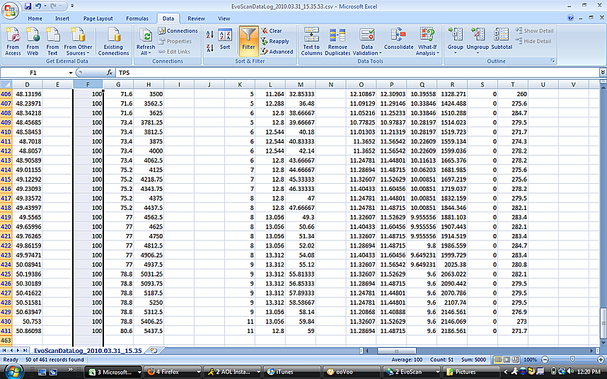

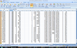

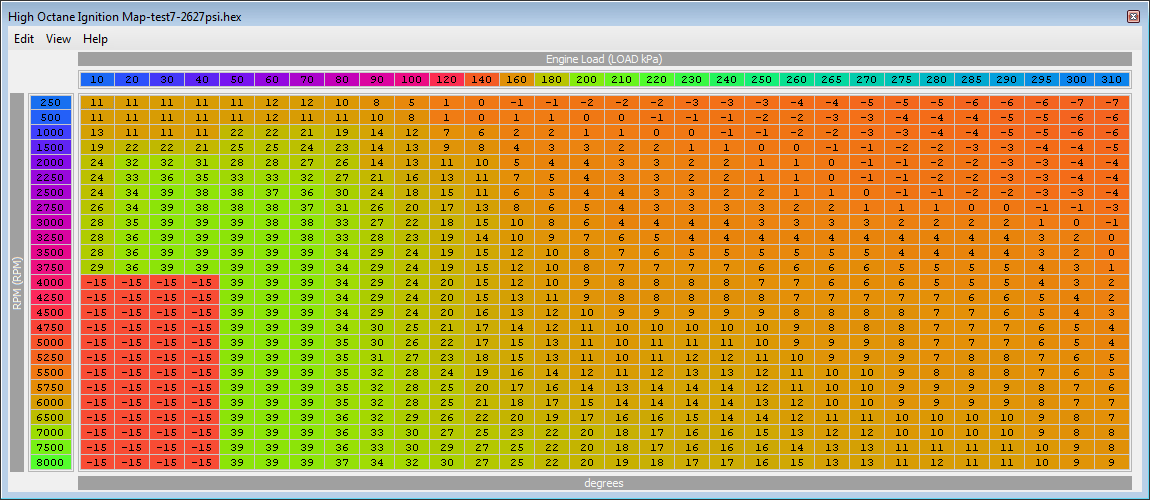

hey,so i randomly walk with my laptop to log different roads and driving scenarios (yes slowly becoming a tuning geek ) and i did a w.o.t pull coming from school and my timing at P.T/P.B was maped at 4 and logged at 6.. there are a few places as well that the timing jumped a degree or two as well. but is this normal? i mean i would think it would be extremely consistent. i only saw this "anomoly" once so let me know if its normal thnx in advance.

Yea I'm logging 1 byte load x=1.3 umm seeing 290 ish load were I leve I'm about 300-700 ft above sea lvl. Also I have all my egr stuff disabled because of my old car withe the swap use too do it alll the time. I mean I don't mind the advance if the car takes it. I just want want consistency. And to address the false load reading I retarded the timing to speed up spool up and there are no 6's in that rpm zone haha. Ill post the log as soon as I get out of class and check out the log I did on my way to school(I was late)

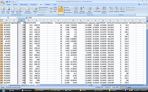

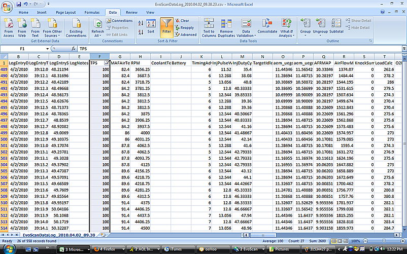

here are pics of the abnormal logs. and map trace
Attached Thumbnails timing advances on its owne-bad-timing-advc.png   timing advances on its owne-wierd-timing-adv-1st-pull.png   timing advances on its owne-3153407.png   timing advances on its owne-31534427.png   timing advances on its owne-3223.png

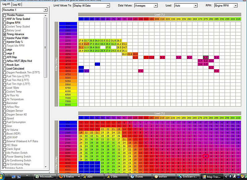

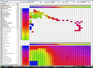

and my work of art never finished map haha

I don't think you understood what I was saying...
You may be logging a different load than the ECU uses to look up timing. For example, if you are logging 1byte uncompensated load, that isn't the load the ECU uses to look up timnig.
The ECU uses baro+temp compensated load for timing when intake temps are < 77F. When > 77F, then baro compensated load is used.
