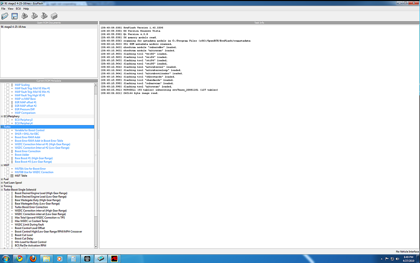

i took another look at your screen shot. You are using psi based control for 96940011. I use the ecu load based control along with gear control for 96940011.
There are 3 load tables for wgdc in 96940011. Typically you use #1 and #3 when using the gear control of boost. At least that is what i have.
If you have the setting very high for the swapover for gear rpm ( say well above 120 ) then the ecu uses load table #2. not 1 or 3 IIRC check that out along with mr fred's how to for gear based boost control for 96940011

I have yet to tune my wgdc so right now its starting at 20%. Here is a screenshot of what tables I have to work with. Can you send me a copy of your 96940011.xml file so I can compare?

Do'h! I didn't attach the screenshot. Will do that when I get home.
