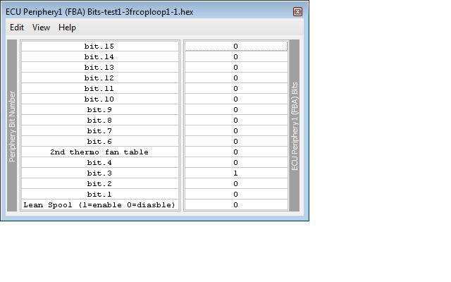

I have also checked the corresponding periphery bit and it is correct. The bit is in FBA section at the bottom list and is set to "0" for 'disable lean spool'

Originally Posted by Booztd 3
Lean spool has been disabled from the beginning....
This is Tephra V7 Option 4....
From Tephra V7 Page
I have also checked the corresponding periphery bit and it is correct. The bit is in FBA section at the bottom list and is set to "1" for 'disable lean spool'
FBA bit .0 aka leanspool set = 0 is disabled... not 1..
i think we found your problem..

My bad, had a brainfart and typed "1" instead of "0" in a previous reply. (Previous post is now edited) Here is my current settings.
I have not altered them, they come like that with Option #4 of Tephra V7 96350706
