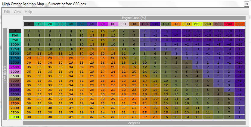

Just installed GSC S1 cams and a 3 in ETS front mount, and I have a few questions. I wanted a lope in the idle but it seems a bit much for S1's, as you can see bumped the timing at idle to 8* and not much change. Should I change the target idle rpm? Also I have not done any WOT pulls since the cam install last night and want some feedback on my map before I do. Mods are in the sig, 91 octace, 21.4 psi. Please let me know your thoughts fellas, thanks

Should I adjust the ISCV tables instead? Reading through Merlins' ECUflash manual pretty much says don't touch the target idle do the ISCV, but I would assume raising idle would fix it, is that what you do? Also would you glance at my spark map and see if you think its okay to do some WOT runs? I know I'll have to make adjustments after the cams, I just want to make sure it is a safe starting point. Thanks for your help.

Oh I'm an idiot I just re read your post, so right now I have 8* in there, what would you recommend changing it to? My bad, I misunderstood.

Umm really, no one will comment on if my map is a safe starting point?

Sounds good, but i have not had any problems with it so far, would it affect idle? Does my timing map look safe to do wot runs and make adjustments for the cams? Which bov works the best? Thanks for the help.

Thanks you sir, i just sold my stock dv so ill look into the aps. Can anyone comment on my timing map please, i wqnt to try some wot runs but want to make sure the car is safe, thanks again.

You should be ok to do some pulls with that timing table.
Make sure you get your O2 spot on before you start upping the timing.

Sweet thank you sir, oh and its 91 octane and 21.4 psi, still looks good right?

Its okay. it might get a lil knock but nothing bad. if you wanna be safe, just lower it a couple degrees across the board.
