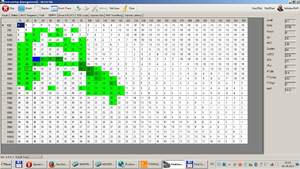

Sorry for bringing this thread back from the dead but I just want to share a bit and also give thanks to the super knowledgeable folks who gave input. I was having the exact same problems as the thread starter and it had been driving me crazy for WEEKS. Here are my mods:
Galant VR4
EVO 8 ECU
EVO MAF
EVO Knock Sensor
T3/T4 60-1
Tial Wastegate
Aeromotive A-1000 w/ fuel cell
FIC 950's
FMIC w/ 2.5" pipes short routed
3" exhaust no cat
That's it for the bigger items
After going through the thread and retorquing my knock sensor (it was in too tight) to 15 ft/lb, I reverted back to the stock EVO fuel and timing tables. I then went through my high octane timing tables and smoothed everything out so that there was no more than 2-3 points difference in adjacent cells. This helped a bit but I still had the spikes in the problem area. So I went and took 5 degrees out in the 2500rpm/90load area. Smoothed out the cells again and went for another drive. I tried every possible combo that cause my knock spikes and the knock light never came on!
Thanks for the time all of you spent troubleshooting the problem. It was hugely informative and is still helping people

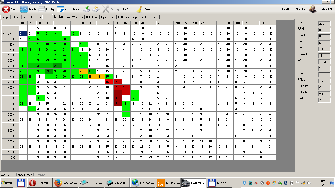

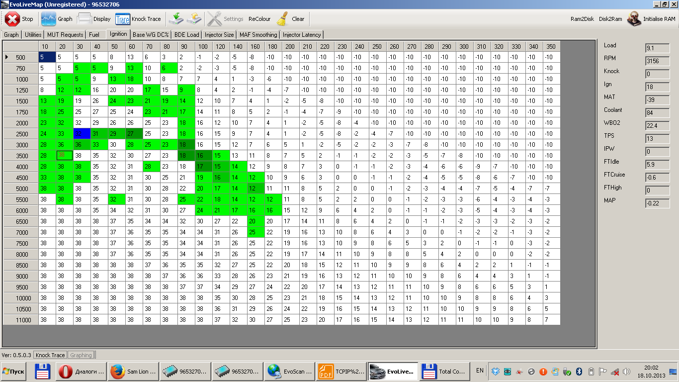

Knock
This is become annoying.
My Evo IV have stock injectors with Aeromotive In-tank fuel pump and stock cams.
It seems like high knock (4-6, sometimes 8) happens when throttling from idle to half-open or more, at revs over ~3500. If I trying do the same from idle revs, it's nice - almost no knock.
With WOT knock is very low too, sometimes no knock at all.
So, I'm think, that's happens because of low fuel pressure at partial throttling. I mean that pump does not have time to raise required pressure for current boost.
