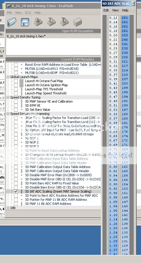

Hey quick question, possibly dumb:
I'm currently on 95361707 speed density. This is what the defualt MAT scaling looks like... Is this right?
I have my GM IAT sensor wired into the fuel temp input, properly configured in ECUflash and I have the MAF sensor completely removed and sitting in the garage.
MAT logs show unrealistically high temps; pretty much always 190-200F.
With the OEM IAT housed in the MAF gone, how does the ECU manage all of the IAT compensated functions?
Does the speed density patch switch all of these functions over to the GM IAT (MAT) sensor?

95630706, those tables are not patched. Just download the ROM that mrfred has patched and copy over the settings.

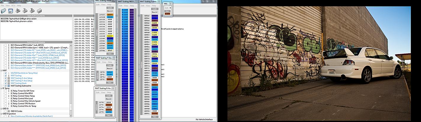

Here are the MAT scalings from http://www.norcalmotorsports.org/use...gst-dma-sd.zip which is option 3 under the 96530006 v7

So I added the values in my above post and got the cruise portions of my SD map within -.47 on my LTFT Mid. I am going to tune boost sometime tomorrow.
Also one thing that I noticed was that I was using Scheides guide for tuning speed density ( https://www.evolutionm.net/forums/ec...ched-roms.html) and when tuning my cruise I only adjusted the RPM-VE table and ended with numbers over 100.
Should I have adjusted the MAP-VE tables at the same time? I assume if I change the Map-ve tables that the RPM-ve will need to be changed?
Oh and thanks l2r99gst for the help. I wouldn't have figured it out if it wasn't for you. The car drives amazingly smooth now.

It's definitely not an XML issue. Those tables that you posted are exactly how they will look with a stock ROM, completely unpatched.
As far as why your SD is working, it probably just has the temp fixed to that high number. It will still work fine with a fixed number, but you won't get temp compensation.
As far as your cold cranking tables, I'm not sure exactly which you are talking about, but usually they are coolant temp based, not IAT temp based.
And yes, from what I remember mrfred saying, any IAT based functions will now be based off of the MAT temp.
Ok thanks!
I get some variation but from like 180-200F only
You are correct about coolant temp- brain fart.
Good to confirm, this may explain a lot of weird little issues I have, if all the IAT based stuff is now based off a fixed high temp from the MAT sensor.
I guess I'll apply the MAT patch to my 96531706 ROM. Does Phenom realize this is not added in the DL, I thought this was standard for V7 and kind of important for SD, no?
