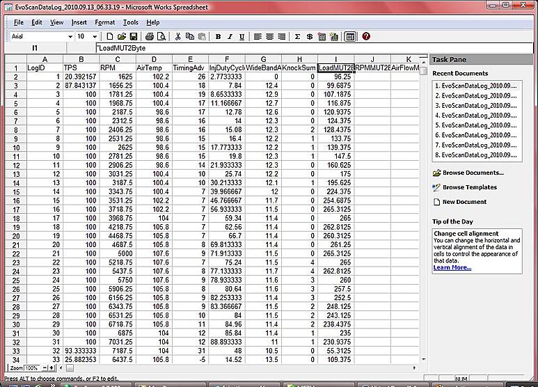

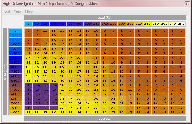

Im not seeing that table in my ROM. My ROM ID is 98640014 .I have a JDM Evo7 and I know your market for Evos started from the 03 Evo 8 so I know my ROM might not been "developed" like the new ROMs. Attached is a night time log (1st) and a daytime log (2nd) and a Timing map

Your logging too many things, and log 2byte load or 1byte not loadcalc(in accurate)...
During spool you go from 9* to 4* then to 3*... Smooth that out and get rid of that knock that is pulling timing...
Do another log with just the neccesities logged...

Bare with me sir. I am very new to this software and still very ignoranant to many things . Im am not seeing 2byte load in my evoscan software just Load1Byte and Load MUT 2byte Mod.

Evopower- Mut2byte is what you want... Just don't use LoadCalc, its really inaccurate.

I have Mut2byte mod selected and all it records is 2741.875 throughout the log .

I posted this in another thread for someone who was also having problems setting up 2 byte load. I just did a quick copy-paste because I need to go to bed, so if anything isn't clear, send me a pm and I'll help you out.
You need to setup your mut addresses to be able to log 2byte load. You'll need to find what addresses you need to enter into the MUT00 and MUT01 tables depending on what ROM version you have in this thread :
https://www.evolutionm.net/forums/ec...te-thread.html
Then enter the corresponding values into your own map, and flash it to your car. For example, my rom version is 88590015. My MUT00 value is 6B42 (entered as 0x6B42 in Ecuflash) and my MUT01 value is 6B43 (again, entered as 0x6B43 in Ecuflash).
After that make sure that in Evoscan your 2byteload is looking at requestid 00 and requestid 01, which correspond to MUT00 and MUT01.

Thanks a whole lot sir. I cant seem to find my ROM in the list tho,98640014. as its a JDM 2001 Evo7. What would i do in this case?

Found IT on PAGE 2 of the thread
MUT00 =885C
MUT01 =885D
So I placed the info in the ROM Mut tables and flashed it to the car. Car now reads 2Byteload .

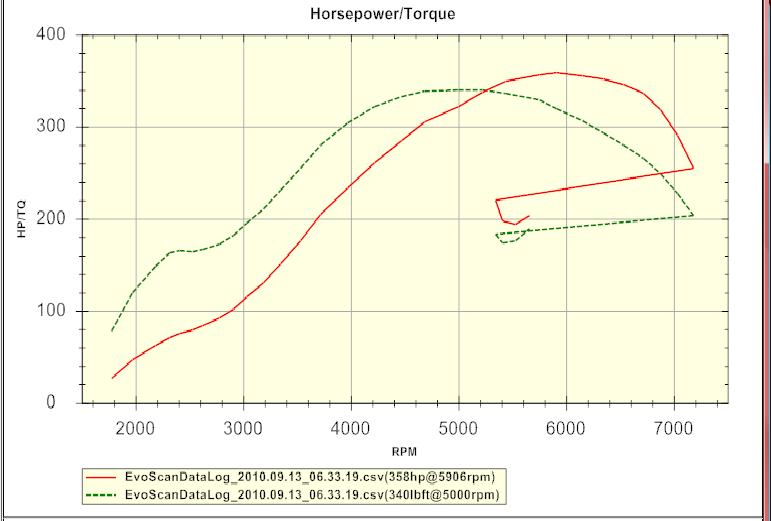

Here is my latest datalog. I have the timing bumped to 7* and richen the afrs to 11.5 range which JOT reccommend . Torque went up some more. getting some knock counts between 5200-7000. Might need to pull 1 or 2* in that area since the AFRs dont look lean. What do you think?

Maybe richen it by .1 or .2 starting around 5k rpm, and pull 1 or 2* of timing and see what happens.

Ill try that. How is it that in your graph you have full torque by 4000. I figured mine should b similar ?
