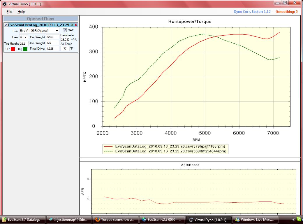

Here's my new power update. I turned up 1 psi (26psi) and made some AFR and timing changes. Car seems to like mid 11s AFRs even with the 50/50 water meth. I know the power defintely came from the cool Air Temps at night

Your peak torque is still insanely late. People don't realize that when adding meth to the mix that ideal AFR is actually richer than pump gas. Used in conjunction with the cooling properties of the water mix allows you to basically still run the same AFR's as ou would with pump gas. I don't know why people think it's wise to run a lot leaner AFR's when running that combo but it doesn't make any significant gains anyhow.

Peak torque does come on late.. I wish I could pull up a recent log of mine.. Pretty sure I hit peak torque before 4k or so

I put 2 turns of preload on the WGA. Ill see if that helps. Can it be the Buschur Race intercooler's pressure drop?
