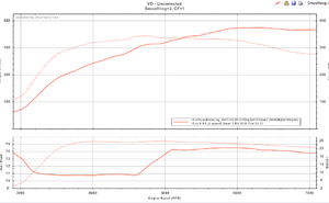

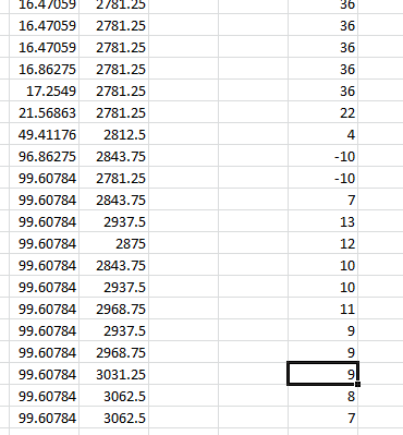

. Also, my timing in the indicated section is approx 15* and decreasing I cant explain the 4* either. This is under 100 load, like 90ish.. I dont feel it studder on a WOT pull like this, but the timing jumps in exactly the same fashion under part throttle where the studder is prevalent.

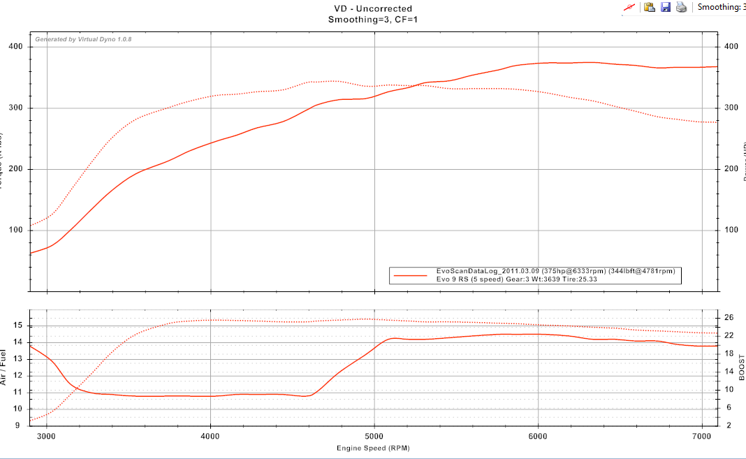

now my fuel is doing the exact same thign out of nowhere! this thing is bogus. nothing has changed in the tune. Piping is all secure.?? puzzled face.

What fuel pump are you running?

Wallbro. You think it went out?

Might be something to check out. I know I saw a thread not long ago where someone started a pull and noticed the AFR was still at stoich. He switched out the pump and everything came back to normal.
Also make sure you didn't blow a vac hose off, I don't know if it could cause this but you may as well check it before shelling out for a new walbro.

Did the engine bay visual, but it did seem like i had to retune the entire fuel map all over the place richer plus tip in was hella spotty
