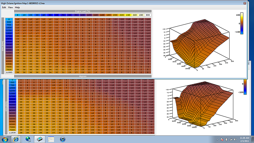

Cann anyone tell me what is going on here?
I am having a hard time determining where this odd timing jump is comign from at part throttle. maybe a cam/crank sensor issue?
Things I have done to eliminate: Changed low oct ign maps to the high oct maps, to eliminate the interpolation between two very different maps, no change resulted. I have increased timing in the low RPM ranges at higher loads a bunch, to no avail it comes up with "mysterious" negative timing numbers against my will. Also, the 2000 rpm range is not the only area this happens. I could do the same thing at 3000 rpms aswell. Although, it will come out of it when the RPMS are a few hundred above 3000. If I get stuck in this studder at 2000-3000 rpm, (IX Rs 5spd) I can add TPS to get me out of it. but as soon as I let off to trim speed and retouch the throttle again to keep speed, its back. this is a huge PITA to drive normally. the car can only be driven in "race mode", which doesnt work in the winter, let alone in the summer!!!!! TICKETS@!!

How do I post a rom small enough? i come up with a 147kb with 100 max

I cant upload the ROM to the photobucket acct either. The IMG above, should still be legible enough to get the picture.

I am running 1000cc pte injectors, scalled according to the source thread on here. Also, running 93 octane, and hks 272s with a TBE, intake and MBC.
I havent been increasing timing because with wintery roads, its really hard to get a nice pull any where. I am trying to get this thing drivable first and foremost. Regardless, are you speaking of the top end timing? this map is supposed to be my safe map before I start having fun

The LoadMUT2byte seems awefully high for what appears to be cruising at ~2-2.5k considering the ~25% TPS input.
