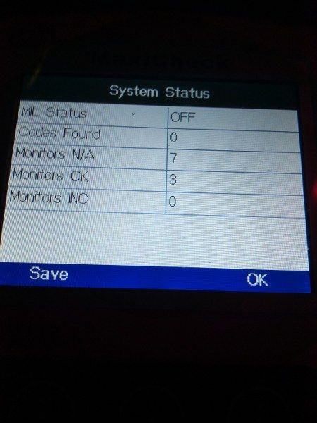

i think it's related to it being an early version of Tephra SD, it's not saying your test failed, it says they are not present
same like with your MAF stock rom where you have 3 N/A and 7 OK, with your tephra you get 7 N/A 3 OK
Unfortunately i'm not really familiar with the emissions testing in US, in EU we need to pass sniffer tests here

Thank You for trying anyway. What is new tephra? V7? Also that number 3 in scanner will always be there. Regardless if everything says Ready, or N/A.
