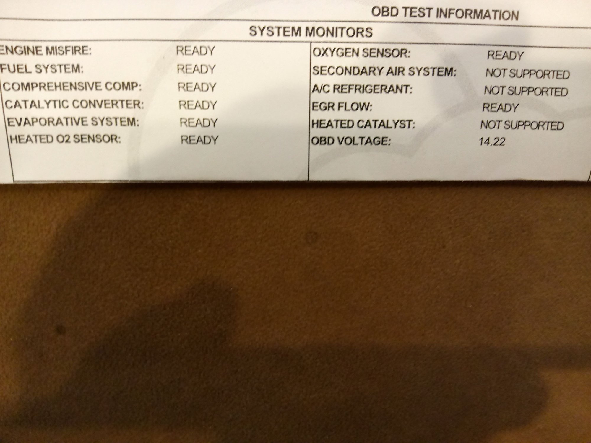

Creamo please help me. My emission pass in tephra dont work. OBDII monitoring N/A.
When I flash old stock rom (MAFF sensor) OBDII monitoring READY! Am in Chicago, I will pay. Please help. Petr 773 895 4241

I just passed emission today morning. The patch is absolutely the best thing ever. However we could not get patch to work in Tephra 88591715. Diagnostic scanner says everything NOT SUPPORTED (except 3). I tried in stock ROM 88590015 with my last MASS AIR sensor Map from 2017 and emission scanner was PASS. I saw small light at the end of tunnel. All I did was disconnect the battery, changed barometric sensor back to OEM and installed mass air sensor. Drove to testing and hoping no check engine come out. I am so happy, my last two weeks were so frustrating. I still want to know why it dont work in Tephra, so in future no need to swap parts. Its sad nobody answer to thread no more. Hard to get help. Most helpful threads are 10 years old. I love my evo. Its a weapon on wheels.
Does not get any better readings then this.

should work fine with tephra tbh, might be your definitions are out of play...
attach your map here and i'll check
