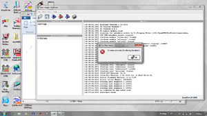

ROM read problem
what is that any idea
I had an issue with mine reading my ROM off my car. I then ran the ECUFlash ECU Inlocker 2.0 first, then ECUFlash and was able to successfully gain access to the ROM off the car. Hope that helps.
i have tryed that but not working
try reading the rom with the eng running

i have tryed to do that also but no use it will show the same massge

what ver of cable you have? could be a bad cable, I had problem with cable and I returned for a new one.

i have tryed the 1.3 and the 2.0 and both worked in other car very well

if it logs ok check wiring loom between white init plug and ecu
