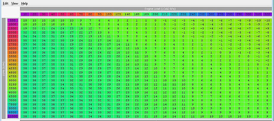

Well guys there is a thread for the 2.0ltr maps, so lets get one going for the 2.3ltr Maps
anyway ill start, this is not finished its my run-in tune MAP on 20psi, 23psi is seeing me at 320-330 load so i will be rescaling this to 400 load later on.
heres my map
2.3 with GSC S2 and GT3037S
Compression = 9.0:1
fuel = AUS 98R i think its about U.S 93

i guess your tune is conservative in the middle and upper range, isn't it?

Yes mate it is (Run in tune)
Its only a brand new motor, i will re-post once its completely tuned
Care to share your maps?

Your compression ratio would be helpful as well.

Ah yes good point, i have updated my first post

2.3l, Kelford tx272, stock evo9 turbo, RON98 (93 octane)
26psi tapering to 19psi. 290-200 load

290-200 load
what rpm ?

I'd venture to say your fuel is better than 93 octane if you're not seeing any knock.
