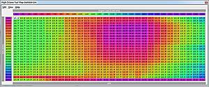

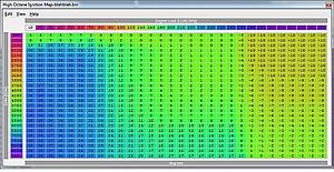

I am very happy to show my maps so far~ Sorry english no to good. How do these look for first time tune.
I want to use tephra because it allow more custom tune. Bigger = better W =)

You run very low timing during spool-up. Is this to maximize spool time? Can you run some of your logs through Virtual Dyno?

yes I want to make really safe for now no money to build

How much load are you reaching? If it's anything over 260 you need to get rid of that negative timing.
The timing at spoolup is very low as well, I understand you want to make the tune safe but even then there's no reason for timing that low. Make the transition smoother and you along with your car will be happier.

Just change from stock map to tephra. I dont think it will go higher than 260

Does the fuel map look acceptable?

To be honest with you, the car will be easier to tune on Tephra V5.10... bigger is not always better...

fuel map doesnt look bad as long as you are in the AFR range you want to be. timing though, like raptord said, i think your car will like a little bit more advanced timing at spool up and peak torque. also, in the higher rpms, you want to avoid 2-3* jumps as it will tend to trigger knock.

What rpm, load are you saying low timing ?

180-260, and 2000-4250rpms

thank you. What would you intend for timing that would be safe?
